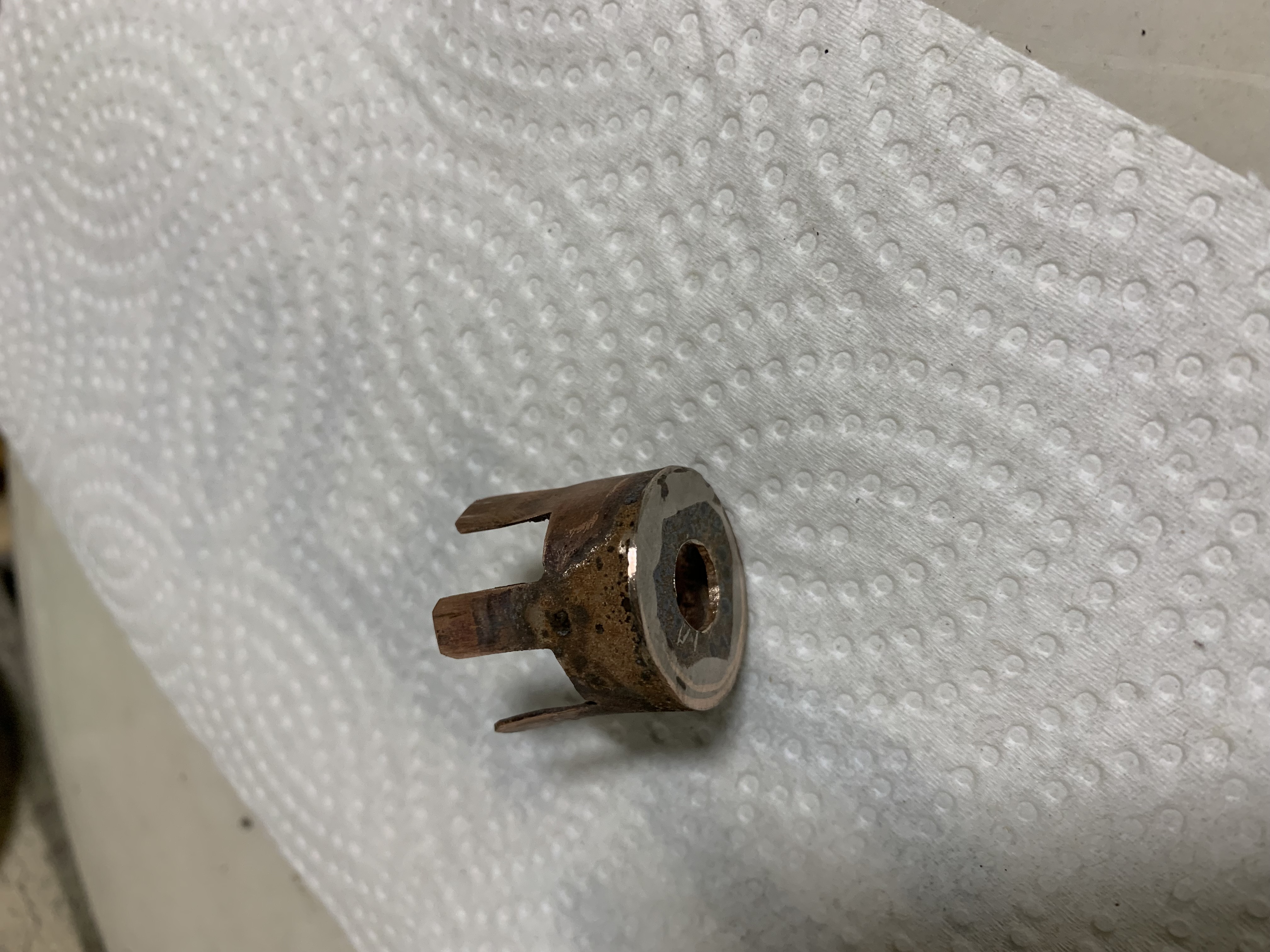

Would like some help… Three sets twin white wires 74 2.0 D-Jet harness I believe are the ground wires.Does anyone have a picture of how this works TIA Dennis

They connect to a trispade terminal which mounts to the upper engine case, rearmost case bolt.

QUOTE(JeffBowlsby @ Dec 14 2025, 04:20 PM) *
Thank you was looking for something like that but seems to be missing… I’ll make it work

QUOTE(Ron914 @ Dec 15 2025, 09:36 AM) *
Hers a photo showing where the grounds are for my 1976 D-Jet @Flyinlow
Yes I see where you’re at there much easier than the original spot on 74 car…I can make something that will work there. btw it would seem I should have connected those ground wires before engine install… lesson learned!!

Flyinlow
post Dec 16 2025, 06:35 PM
Flyinlow
Posts: 104
Joined: 17-October 20
From: British Columbia, Canada
Member No.: 24,774
Region Association: Canada
QUOTE(JeffBowlsby @ Dec 15 2025, 05:18 PM) *
QUOTE(Highland @ Dec 15 2025, 04:12 PM) *
Curious why there are multiple ground wires on the FI harness. Why not just 1 wire or ground the ECU case to the mount (chassis)?
6 circuits total. 1 ground for each injector, 1 for the ECU, 1 for the TPS.
They could be functionally combined into a single ground point. Probably configured this was for easy harness construction.
Made this today and it all worked out nicely… thanks everyone …again!
