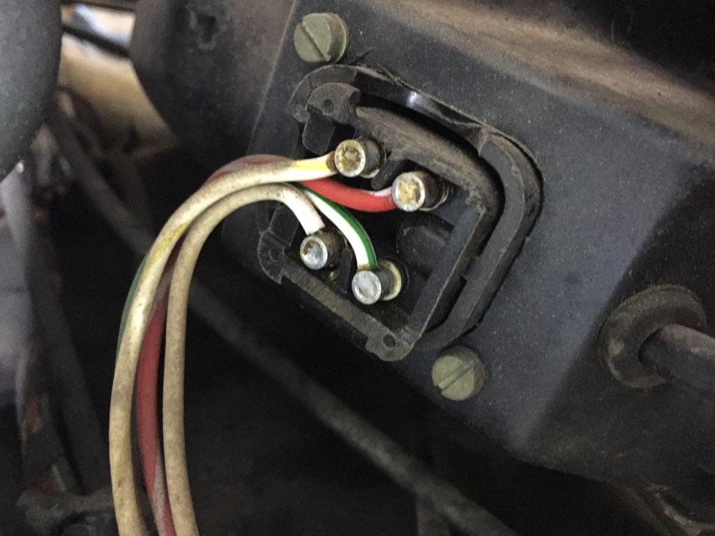

Here’s the fans inputs. Red is 12v, the other three are ground that you activate at the vent control. Do you have 12 V ?

QUOTE(jim_hoyland @ Aug 5 2025, 06:44 PM) *
Don't recall if that plug is accessible from the outside? Maybe it worked loose, or not a good connection.

Member No.: 643
IIRC , the plug attaches to the bottom of the blower assembly
