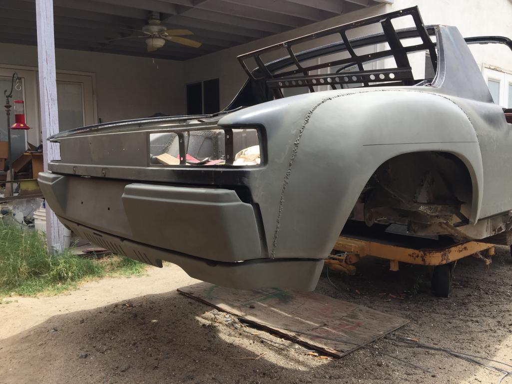

If you are adventurous it really was not that hard to flare the stock valance. Once the flare is installed you can make a template right off the bottom of the flare for the new top plate for the valance that has the right shape. I went slow

QUOTE(Shivers @ Apr 27 2025, 11:09 AM) *
@cosm3os
Is that some sort of cutout / detail I see in the center of the valence? Love it.

QUOTE(RiqueMar @ Apr 27 2025, 12:57 PM) *
@cosm3os
Yes. The plan is a recovery point.
